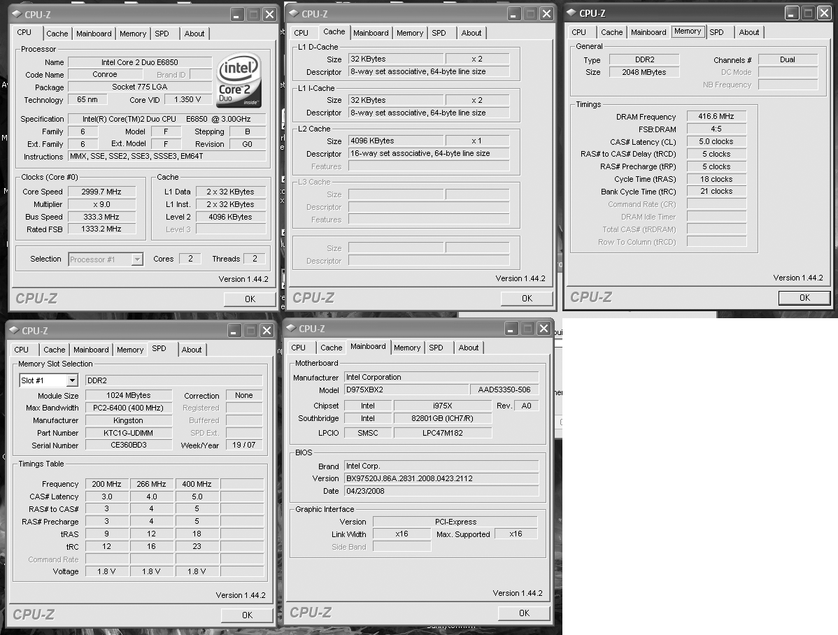

Uploading a screen of CPU-Z running in windows showing the FSB and stuff.
its in greyscale because of the upload limit of 256Kib
I have a few concerns, is this "overclocking" my fsb? Is this damaging anything?
I havent noticed any artifacts or anomolies yet, runs perfectly smooth, no hitches.
Left it on all night too.

Re: Intel Bad Axe II and E6850 (1333mhz on 975XBX2)
I really haven't been following this thread since I'm not a BX2 fan, but here is what I see:sulpherdragon wrote:I have a few concerns, is this "overclocking" my fsb? Is this damaging anything?
Well if your FSB is rated at 1066 and running at 1333, yes it is overclocking the FSB. My FSB is rated at 1333 and it runs at 1600 with ease. Is it damaging? Nope, not in the least. Just monitor your temps (NB, etc.) and if all temps are within spec, then you're golden.
If you want to ensure that your system is stable, then just run Prime95 overnight and see if it throws any errors. Looks just fine to me, and you even have a slight overclock on your ram.

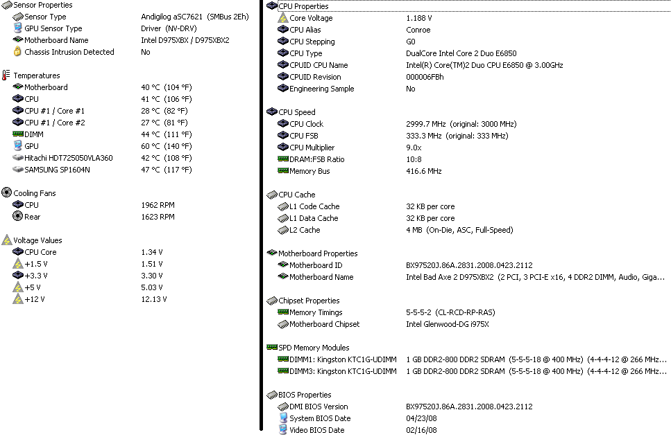

I love computer hardware however ive never gotten straigt answers for somethings, i have a few questions:
My ram is supposed to be 800mhz, yet the "max bandwidth" is 400mhz, is that because of the "DDR" factor?
the ram timings 5-5-5-18, is it better to have high ones or low ones? i think its low, but then ddr3 switches it all about.
Why does it say my DRAM frequency is 416.6 Mhz? i thought it was 800mhz ram which i clocked down to 667mhz in the bios!
What is the Memory Frequency? my ram only works in 266mhz, is it supposed to be higher? my bios says i can go as high as 333mhz, but on the image above my ram goes from 266 to 400, is that why 333 doesnt work?

1. max bandwidth is 400 x 2 seeing how its DDR2
2. lower timings = better performance vs higher numbered timings, but the real performance boosts come in higher clock frequencies (900 vs 800)
3. DRAM freq is 416.6 so refer to #1 and you've overclocked your RAM to a nice 833.2Mhz over the stock 800Mhz
4. might have something to do with the divider... i'll let more experienced people answer that one :D

Your RAM is running @ DDR ~800MHz+ speeds.sulpherdragon wrote:I love computer hardware however ive never gotten straigt answers for somethings, i have a few questions:

I ran Everest Ultimate Enginneering Edition;
The temperatures on the left seem fine, well below any bad levels (correct me if im wrong).
However the DIMM temp is higher then i would have expected (But 40-50 degrees seems to be the ambient temperature of my case).
Under Chipset Properties, it says 5-5-5-2, yet my ram is 5-5-5-18.
Whats going on here?
Also, one last thing, my processor speed keeps changing, it goes from 2999Ghz, to 1999Ghz, to 1999.8Ghz then 2999.7Ghz.
Its the multiplier (going from 9x to 6x and back again), but why? its not overheating! My PSU is 700W and currently reads that only 110W are being used, its not like its suffocating.
My memory bus (416.6Mhz) changed on a much smaller scale (it stopped now). But every few seconds it would go from 416.6Mhz to 416.8Mhz

I believe the changes in processor speed you are seeing are a result of having speed step enabled. Basically when you don't need the extra performance it turns it down a notch to save power and reduce temps.
sulpherdragon
- Legit Enthusiast
- Posts: 27
- Joined: Wed May 07, 2008 4:15 pm
Yes thanks! I noticed my laptop doing the same thing so i got less worried.
