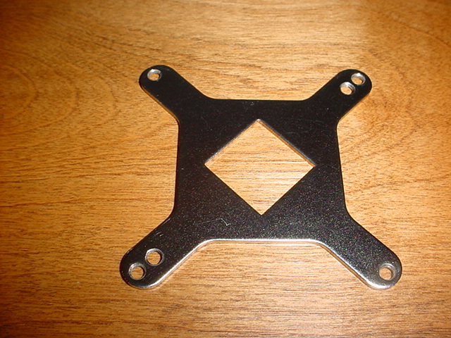

My system came with a CoolerMaster Mini Aquagate R120. I had to replace it after 3 months because it leaked (not from the tubing, but from the water block itself). When I took everything apart to swap it out, I noticed that the system builder had not included the "universal back plate". When I was putting it back together, I noticed why- the back plate wouldn't fit without touching some pins. I thought the support would be helpful, so I notched the plate so it would seat without touching anything.

Almost every 775 MoBo out there has something on the backside under the CPU area that can come into contact with a backplate. Some backplates can be notched as about and others are made out of steel and come with a thick (1/8") foam pad to insulate the plate from the board. You'll just have to try which method works best for the board that you get.
As for myself, my water bolck doesn't require a back, but I modded a heavy steel one with a foam pad because it adds a ton of extra support to the board and keeps the board from bowing when you apply high pressure to the water blocks mounting screws to mak better contact with the core..
This is the type that I use on my systems, it's from Scythe..........
