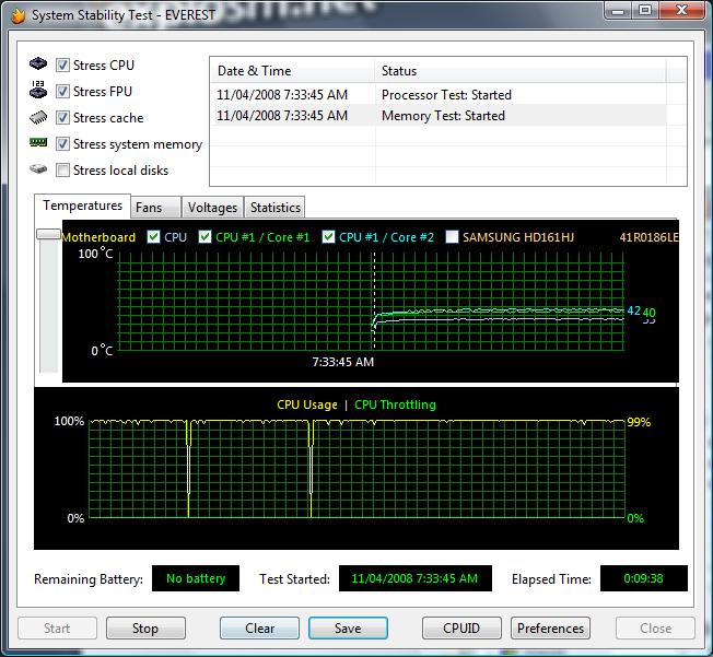

Another update, I have set the FSB to 345 X 9 = 3.1Ghz (actually 3.105)
but when i try to get it to anything like 347 or 350 it posts but my sata Hard drives are 'their' They just down show up...
The PCI multiplier is locked at 33Mhz as the Eastune 5 reports, so i think that, that is locked.
I ran a quick stabiliy test with it at 3.1Ghz
