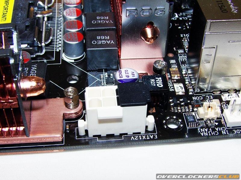

1) It says that the power is supplied to the Striker II Extreme through just two connections - the 24-pin ATX connection, and the 8-pin EATX power -
so I should be connecting the ATX 24 pin from the corsair psu to the 24 pin input of motherboard,
then as you can see in the picture there is the ATX 12V on the motherboard, it has 8 pins however 4 pins are covered with a black plastic
- what should I be doing? should I be detaching the 4 pins out of the 8 pins from the corsair psu and insert 4 pins into the motherboard or remove the plastic covering from the 8 pin ATX and connect the 8 Pin from PSU.

1) Remove the black plastic cap from the EPS12v connector so you can use all eight pins. The plastic is there to show users where to plug in an AUX 4pin connector IF they do not have an EPS12v connector.
