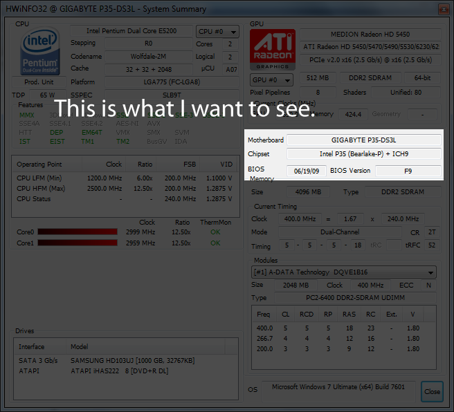

If you want to see which BIOS you're running download HWiNFO64.
http://www.hwinfo.com/files/hw64_392.exe
Start the program and you'll see a little window pop up. In there it should tell you the BIOS version. See pic.
HWiNFO32 Example.png (71.38 KiB) Viewed 7413 times
