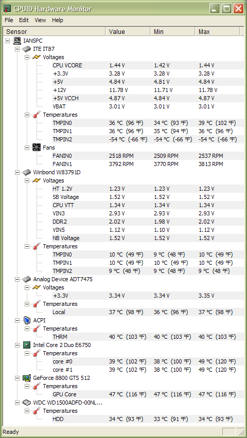

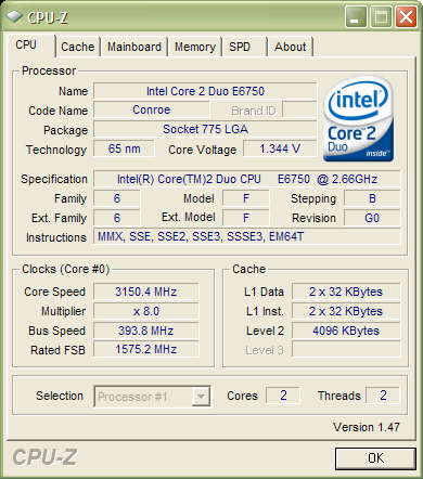

Okay, so I'm making a little bit of headway.
Shots:
I'm testing at 3.15Ghz now with those specs. Assuming I test okay in Prime 95, what would be the next step to getting that 3.33Ghz OC that I want?

Froze a few minutes in, looking at my voltages and all, what would you do? I'm "safe" up to 1.5v so I'm open to suggestion.

safe up to 1.5 in bios or safe up to 1.5 in cpuz?
stopthekilling77
Posts: 2188
Location: Colorado, USA
Re: climbing the Ghz ladder... sort of
Post by stopthekilling77 »
HWMonitor has been off less than .01v every time I've changed voltage settings in the bios - CPU-Z has been reading WAY off.
In all actuality I could probably lower my vCore @ 3.0Ghz right now because I'd gone from 1.38v trying to get 2.95Ghz to work in a jump to 1.45v to see if 3.2Ghz would work. I'll minimize my vCore and see how my temperatures are when it's stable, just for reference.

cpuz is probably closer
stopthekilling77
Posts: 2188
Due to vdroop or something?
thats a whole 0.1v discrepancy... o.o
