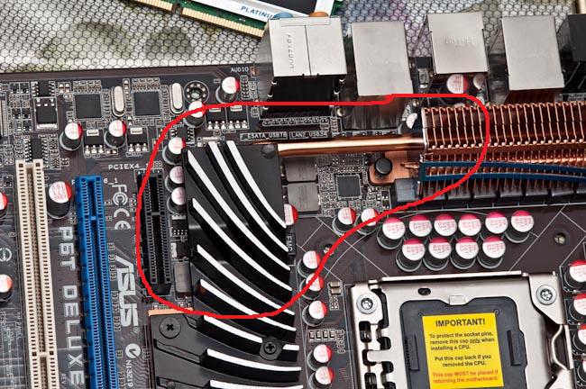

OK I took the damn thing apart.
There was NO smell AT ALL from the PSU. Nada.
The paste seems to have been enough, even a bit TOO much, and it was definitely flattened between the CPU and cooler. (See pics)
The chip did not smell at all, even after I lifted it up and smelled it real close.
The only place that had a faint smell, similar to the one I had after it happened was the area I circled in red. (pic)
I did not spot any obvious melty places.
So, what do I do now? Send back the mobo? What do I say? I don't see how this can be my fault. The BIOS settings were almost all default, like I mentioned above. I ran Prime because I intended to OC, after I used the computer and learned way more about it, but I wanted to see the baseline. That's why I went for the Asus and not the Intel mobo. But this all happened on default settings.
Thanks for all your help...

Re: Catastrophic failure ***Pics Added***
The board might have 'popped', so is there a way to borrow a friends board to see if that is the only thing that is wrong? If there is a local store like Frys or something maybe you can swap boards quickly.
Actually there is this - http://forums.legitreviews.com/about18726.html
You should be covered under ASUS's enthusiast RMA program and they will cross-ship a board to you. I haven't used it yet to see how good it is, so if you use it be sure to post back how ASUS treats you. If they don't take care of you I can yell at them for you as I have several meetings with ASUS during CES :)

How does the back of the motherboard look?

back looks ok.
