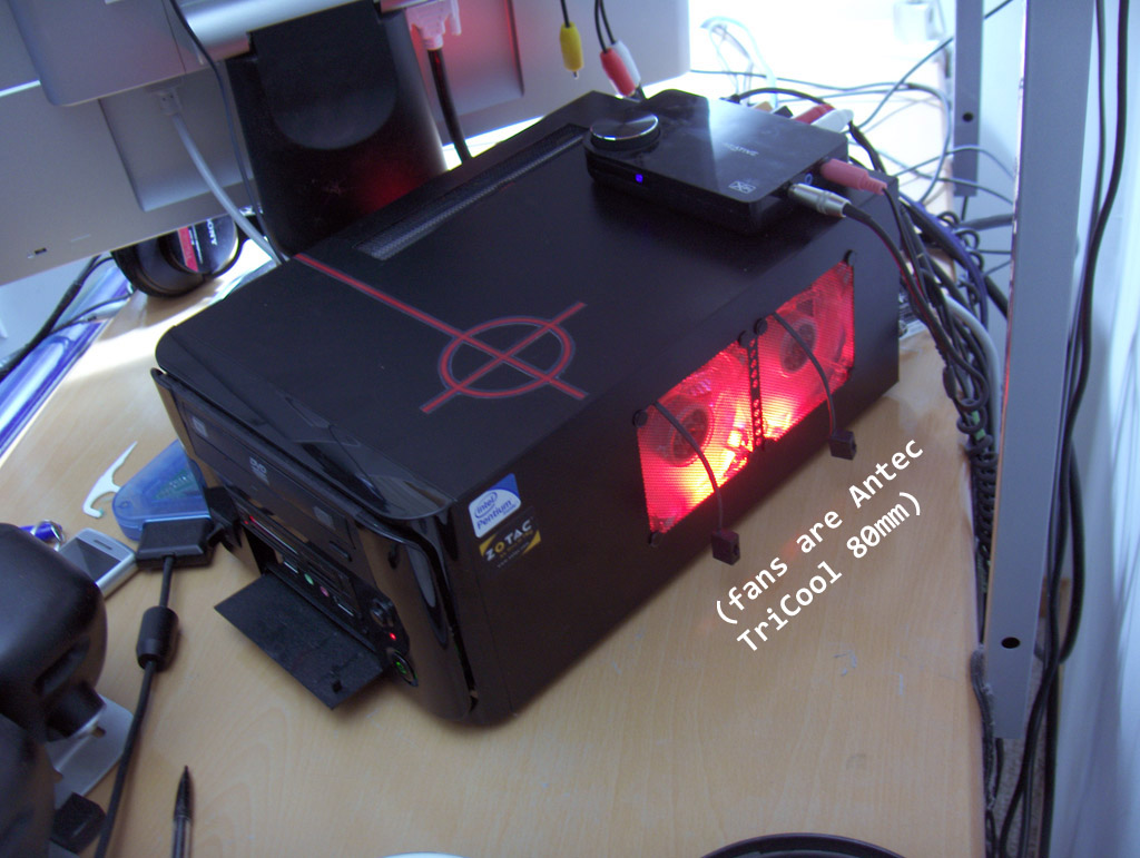

Outside view
Outside view
HPIM2148 tricool.jpg (208.6 KiB) Viewed 9750 times

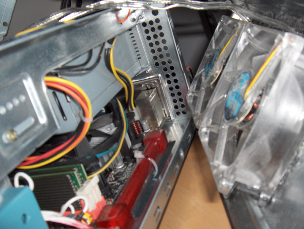

Inside showing Intel HSF & fans blowing on it

To me it looks as if it would be fine, just don't overclock it. If you're that concerned about heat, then just undervolt it at stock speeds and that will lower the temps even more.
I have a Q6600 at 1.1v and it is cool and stable at 2.4Ghz using the stock cooler.
Be sure to activate C1E and turn speedstep off. Your other option is to leave the vcore at auto and enable both C1E and Speedstep.
And yes, undervolting is safe, just make sure its stable using Prime, OCCT, etc...

I would replace the tricools with a higher quality fan. the tricool is the stock case fan that is in most of my cases and i have been replacing them left and right as they freeze up.
