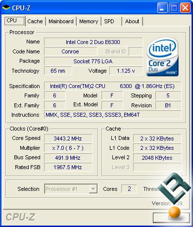

nice, just like how I hit 2.6 on stock with the 3800x2 (on air) Get that thing under dry ice already :axe: . Then leave it running under water after you've had your fun. Glad to see you back at it ken. That is with new hardware to boot. Though I wasnt' that impressed with my zalman gpu fan, the cpu fan I have I love. those cnps 9k series seem to really do the job well.
good job... you already passed up my E6300!
I'll trade you my B1 revision for your B2 revision ;)

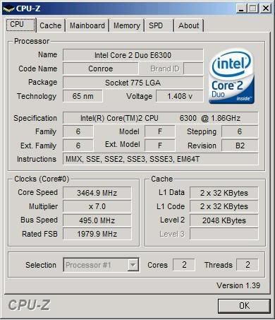

I think 495FSB is my max with this chip! I can't use the 6x divider to test as 6x 500 fails in seconds. I think this is due to the 965 chipiset internal clock speeds.
According to FCG the chipset clockspeed is caculated different than just multi x fsb.
In my case it would be 7/6 X 500 = 583MHz --> which is far too high for 1.65v
Source
I'm also using the 1:1 divider, I know my RAM can do at least 1050MHz 4-4-4 with 2.3v.
I tried 510x7 (3570) but it failed Orthos in 5mins. I have to goto work, but will test more later. I'm actually a little disapointed this was soo easy to do.....I'll have no more tweaking left to do after tonight ;(

For sure! (end of next week hopefully) But I don't think my problem is cooling as I can now run 500x7 but anything higher is no go. I've even increased vcore to 1.525v (61C load (coretemp)).
I think the problem is one of two things, the cpu or the chipset.
I've tested my ram stable @1050MHz 4-4-4-8 2.3v
I ran 5-6-6-12 2.45v when testing 501x7 with all other voltages (chipsets etc) set to max, to focus on the cpu.It fails in 30sec with orthos.
Testing 500x7 is ok for 40mins orthos. :?
I think the problem is the chipset (again), I'm using the 1:1 (533) divider which is known to make the chipset run very tight internal timings. What I need is the option to change the NB strap to 1066, that or a 680i board.
When I add some TIM to the various heatsinks I might squeeze some more........tomorrow hopefully!

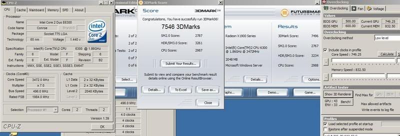

Now trying to do some 3D benchies @3.472GHz ;)

500x7 is stable for 45mins Orthos, after that I don't know. I do know 501 fails in seconds. I've tried 510 / 515 & 520 and all fail quickly too, so I've given up overclocking the cpu.
The GPU is another matter 8)

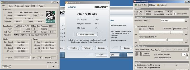

3DMark '06
Old best with X2 @ 2.6 & 2GB @ DDR520
New Setup:

Post by dgood »
that's a pretty good jump in scores from the 3800x2 to the core 2 duo on 3dmark06. It's more than I get on either of those ones though lol. I get 5180 with my fx-60 at stock and my x1800xt. (hence the 1900xtx being better :))

Looking good! A little over 3,000 is about what I get for my own CPU scores on 3dmark06...
