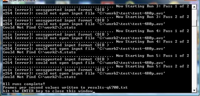

Tried to run but kept getting errors.
Running Vista Ultimate 32bit on a Q6700
I have it in the work2 directory on C, but something about the DIB files not being supported?
I uninstalled avisynth and reinstalled it, but still keep getting the errors.
Mike

Odds are you need to run the benchmark as an administrator, try the right click properties menu to see if you can elevate the permissions.

No permissions necessary. I'm guessing you just didn't copy "DGDecode.dll" from the "C:\work2\Initial Setup\" folder to the AviSynth plug-ins folder (C:\Program Files\Avisynth 2.5\plugins\).

Yeah, probably missing the dll. It has been tested hundreds of times and it will work for ya :)
http://encoding.n3.net <--- for all your DVD and audio CD backup needs!
KnightRid
Posts: 4295
Location: Dallastown, PA
Re: x264 video encoding benchmark
Post by KnightRid »
LOL - I THOUGHT I copied the dll file over, but I drug the damn shortcut for avisynth instead :roll: - Everyone at once...MIKE IS AN IDIOT

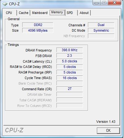

screen cap for you on the memory - LOW and SLOW memory :)
Mike

KnightRid wrote:LOW and SLOW memory :)
That better have been sarcasm :P
