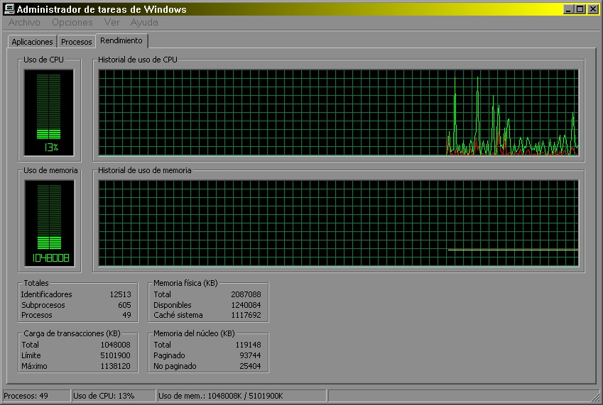

GI-JOE wrote:Bring up task manager and see if there are 2 threads in the performance tab.
I am not sure, since the OS comes in Spanish, so I am attaching a small jpg.

GI-JOE
Posts: 461
Re: New Intel E2200 CPU, working with ONLY ONE CORE - help!
Post by GI-JOE »
Check to see if you have 1 core disabled in the bios.
Also, being windows 2000, I'm not sure if that is normal to show the cpu usage with 2 different color bars for 2 cores or not. :?

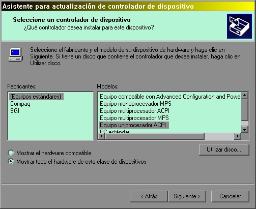

The link you are providing, might give a possible solution, but I do NOT want to spoil everything and NOT be able to boot up my PC again, so I have the following options JPG attached:
My question is if I am on default with Uniprocessor ACPI, I have to change to Multi processor ACPI right?
Thanks again !

stopthekilling77
Posts: 2188
Location: Colorado, USA
Post by stopthekilling77 »
That would seem to be the logical choice. I wouldn't know for sure, as I found that page through a quick few searches on Google. Give it a shot and let us know if it helps! I'm crossing my fingers for you!

stopthekilling77 wrote:That would seem to be the logical choice. I wouldn't know for sure, as I found that page through a quick few searches on Google. Give it a shot and let us know if it helps! I'm crossing my fingers for you!
Thank You very much guys, problem SOLVED with the info on the article that you provided !!! :partyman:
