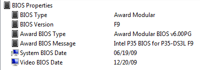

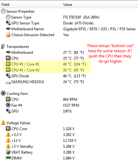

My core temps are messed up in the same board you have (GA-P35-DS3L) with an E5200.
I had the same results with the CPU in a different board GA-EP45-UD3P. So I chalk the readings as an issue with the CPU itself.
*EDIT*
Added Pic of BIOS and motherboard info.

Yep, it looks like the same thing going on. Thanks for going to the trouble of confirming this for me in two separate boards, I appreciate it. I'll just keep it where it is, it'll be kept at stock so temps shouldn't be a problem.
