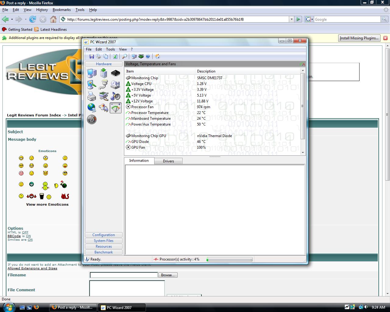

Post by kappage »
It seems that they havnt fixed it yet, because in BIOS my cpu is running at about 50 Unclocked.... and in pc wizard Power/Aux temp is 50.

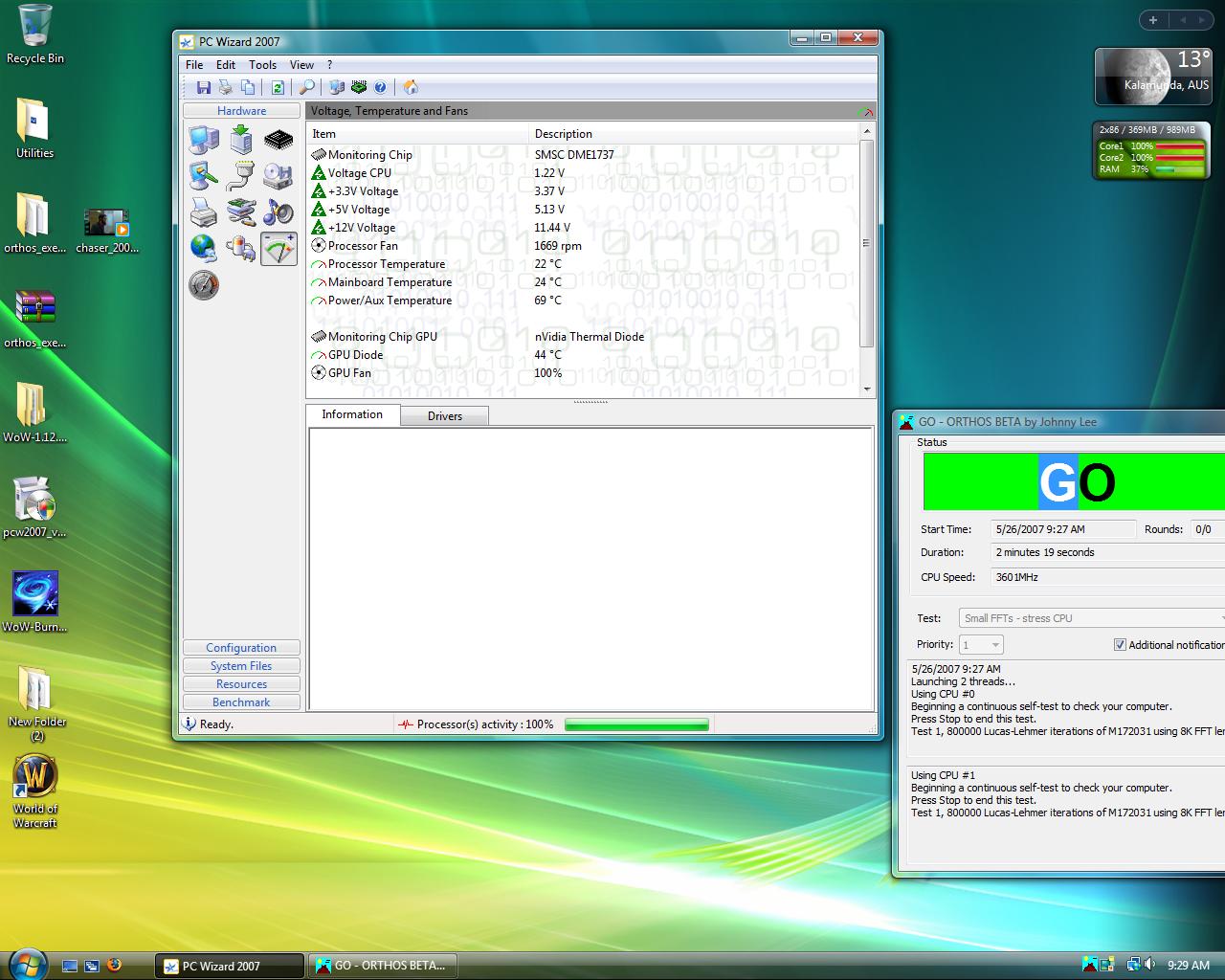

Post by kappage »
Clocked at 3.6 running Orthos the temp increases rapidly heres a screeny. But as soon as i stop running Orthos it jumps back down to about 52

Try using speedfan to monitor your voltages while testing.
By what you had showing above, it's looking like you're running into PSU's cross-regulation failures as mentioned HERE --> 12V is droping down while 3.3V and 5V gone up.

Post by kappage »
So your saying it wont clock any furthur because the 3.3v is going up and the 12v is going down?

Post by Nein »
kappage wrote:So your saying it wont clock any furthur because the 3.3v is going up and the 12v is going down?
I'm saying --> The voltage shift patterns you had above indicated PSU failures from hitting maximum PSU power limit.
I'll not be trying to explain further than this as most PSU "experts" I ran into never seem to have any clue, they had never heard of cross-regulation tests, nor bother to mention it in their reviews.
I have no idea why that should be so, as cross-regulation test was and is what all PSU manufacturers had used to determine their PSU power rating since before the first IBM_PC was made.
