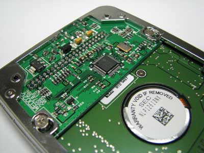

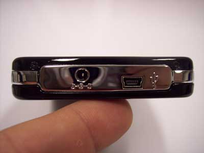

I uses a couple 160gb Samsung HM160JU's for work stuff, love them. Self powered via the USB port, and on the inside its very simple.
