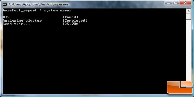

So i moved the drive over to my HTPC with Vista 32-bit and ran wiper.exe (TRIM) and then moved the drive back over to the Windows Vista 64-bit test system.
Everything ran fine in wiper.exe, so I went right back to benchmarking...

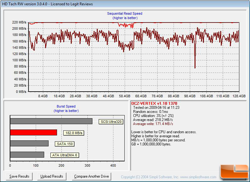

After running trim I left the drive having a new volume (NTFS) and ran HD Tach... It looks like TRIM did something as read performance was nearly flat, which is wasn't before... guess it fixed everything...
To test the write speeds you have to remove the volume, so I did that and enabled the write test. It looks better, but let's run that test a couple times to make sure the results are consistent.
On the third HD Tach run it looks back to how it was when I originally tested the drive... Write performance took a dive once again and the read test is jumpy once again...
Any ideas FZ1? Or does this SSD/Controller get screwed up that quickly?

Re: OCZ Vertex 120GB Hard Drive with Firmware v1.10 Benchmarking
Before Running any benchmarks after TRIM:
After running all the LR benchmarks and going back and re-testing after the drive was used for half a morning:
I formatted the drive, tried with and without the volume on the drive and still stuck at around 215MB/Sec read...
241.8MB/s At the Start of Testing
215.3MB/s At the End of Testing
That is a 26.5MB/s loss, which is an 11% performance drop... That is a significant difference.
