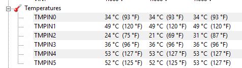

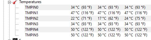

I am still getting the odd temp readings also
From previous post
Just took this reading now
Would anyone have a reasoning for this? seems 1,4 and 5 are always way hotter while 2 is way cooler. Even when stress testing they never equal out.
Re: New system
Do you know what those are even measuring? Those look like random board temperature points. Likely VRM or something. Might want to e-mail Gigabyte with a full report from the application and ask what the temperature readings are actually measuring.
That board has "Smart Fan 5 features 5 Temperature Sensors"... Maybe the Gigabyte application or BIOS temperature menu will explain what those are?
Same board here and its showing what the temperatures are for. Also people explaining why the readings highlighted aren't the same - https://www.reddit.com/r/GAAB350/commen ... _readings/
