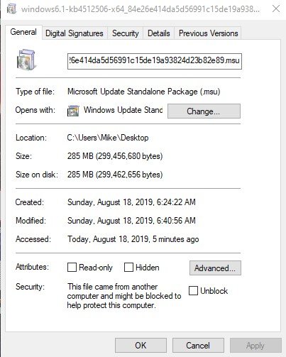

http://www.catalog.update.microsoft.com ... =KB4512506
When you download it manually from there, is the size still just 52.x mb?
I am downloading it now to see the file size on my end but it will take a while cause we are still in the dark ages in the USA....well when you live wooded areas ;) Will edit when its done.
Ok at 120mb now so well over what you were getting. Try downloading on a different computer and put on a thumb drive? If you cant get it I can upload it to dropbox or one of those if you need.
ok, got it - only 16 minutes LOL
let me know if you need me to upload to a file sharing service or something.
