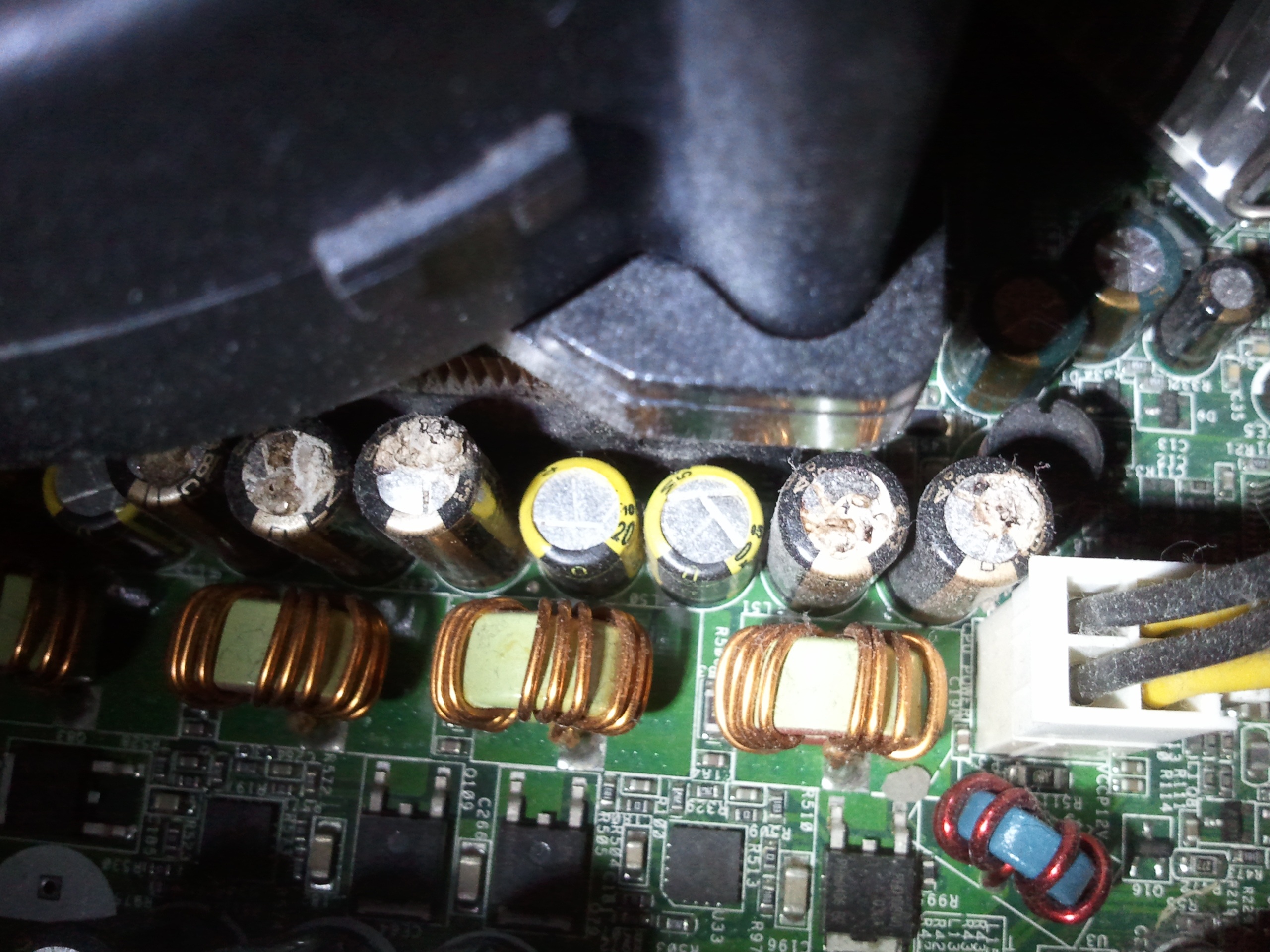

I picked up a used, and rather old (P4 @ 2.66GHz), computer for my father-in-law, to replace a pile of crap that he was using. I made the mistake of not checking it out inside before buying. It wasn't expensive, but I still have worries of possible problems. I noticed multiple capacitors were ruptured on the motherboard. What are the consequences of this? The machine is running fine as is right now, but I've never had a ruptured one before.

Nate, I finally got a chance to upload my image.... this came from my cell phone, so I hope it shows what you're needing to see. I think there may be a couple other blown ones, but I could be wrong. Otherwise I can grab my DSLR and snap some pics on Sunday, when I'm over there next. Let me know! Also, do you still have my cell #?

Those all look like they are associated with the PWM of the CPU. So who knows if the CPU is getting the correct voltage it needs. Too little can be just as bad as too much.

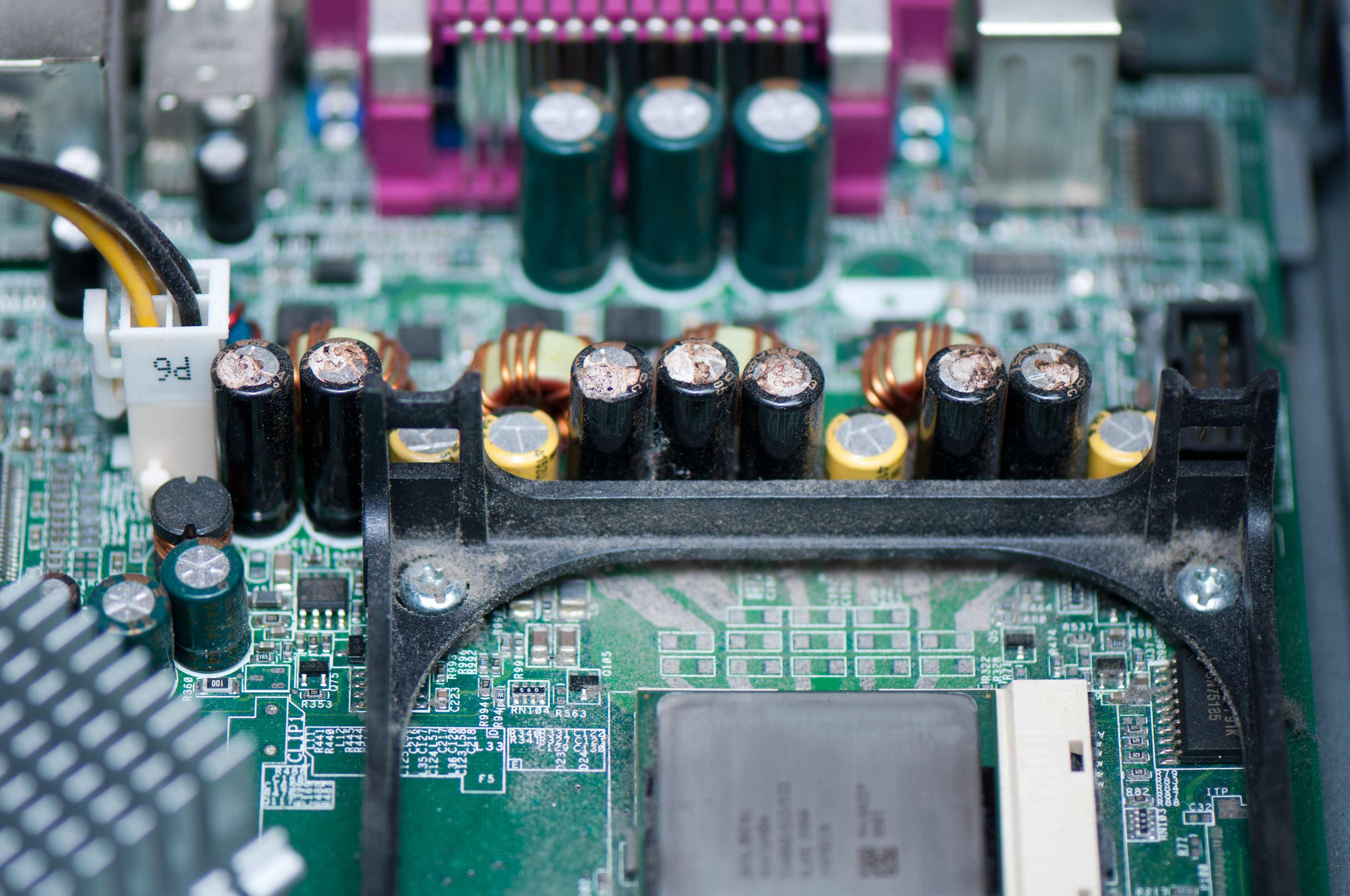

Since I had my DSLR with me today, I snapped a pic. Maybe these pics will better show what these capacitors control? I'm not an electronics expert.

So you grabbed a Socket 775 from work? Basically the CPU doesn't have any pins?
Those caps look like s**t. I'm actually surprised the computer still works.

Yep, they do look like crapola. The computer does work great, though I haven't had the time to run through the torture tests to see what happens. I'll be buying a soldering iron for a photography project soon, so I will be able to replace the capacitors soon after. I took out a daughter board / riser board from the machine (whatever you want to call it), which has 3 smaller capacitors on it, so I'll be able to practice with it.
