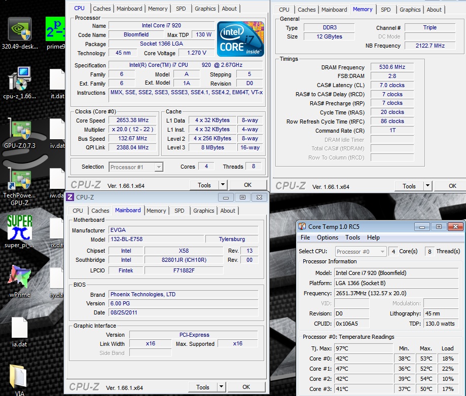

So I am finally getting an i7 (to arrive late this week), granted it may be old now but 8 threads of intel power for $80 shipped (OCN) is too tempting to bear :)
So it'll be a 920 D0 chip, and in an EVGA X58 Tri-SLI i'm picking up at the same time, with 2133MHz (Dual Channel :/) CL9 Ripjaws until I get a set of Triple channel
It will be under a CoolerMaster Hyper N 520 because it's the only heatsink I have aside from stock that will work on 1366
Any thoughts? guesses to max single-core stable for superpi? ;)
also thoughts on using Dual channel vs Triple?
-Austin

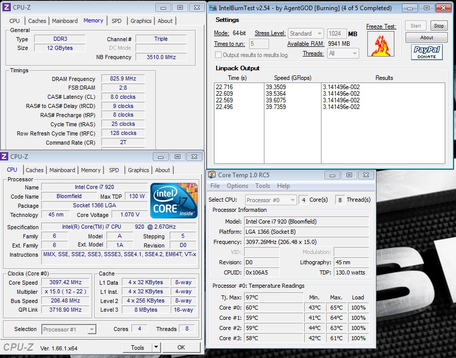

(relatively) Isolated BCLOCK testing, 207 stable, hangs at 210 during the burn test, 7 seconds in, and hangs 14 seconds in at 208BCLOCK
Could go higher there, but only want 1.45v VTT max, uncore multi gave me problems at 192 BCLOCK and higher so I had to lower the uncore and RAM multi's to break my 200 goal
-Austin

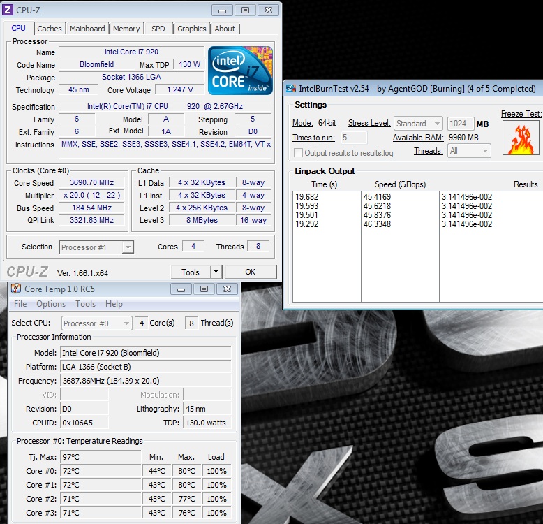

starting to hit a little problem:
wont be going much higher until I get the extreme load temps under control. The instant the IBT stops the temps drop right back into the 40s though...
I've got my Uncore and Memory dialed in at 1873MHz RAM at 8-9-8-23-105 1T 1.65vDIMM, 3746MHz uncore with the 1.45v VTT still
This isn't over.
-Austin

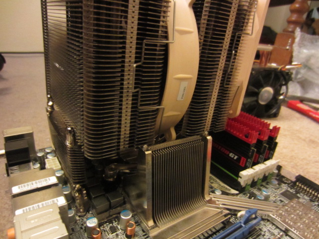

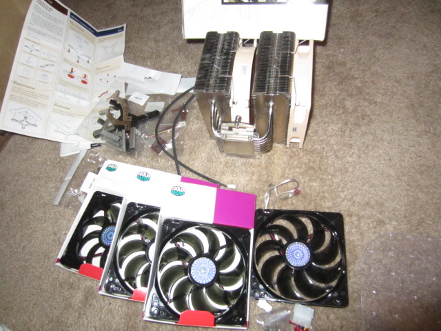

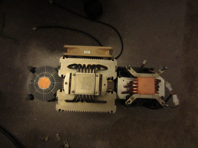

got some new little toys in the mail from Newegg and the OCN forums, Noctua DH-14 and Cooler Master Sickle flow 120's (69CFM @ 19dB, 2000rpm)
But it's a wee bit tight, I actually couldn't have the Mosfet heatsink installed until after the DH-14 was screwed down and the fan is resting on top of the Memory heatsinks so I had to move the Corsair fans off the edge of the other two sticks of memory
I'd say it's a little upgrade ;)
The goodies just got installed last night and I'm on-call this week so I havn't had too much time to play with it, yet, but load temps are around 75 now at 3.9GHz, not sure I can get much more out of this CPU for 24/7 unfortunately, might snag another i7 with a higher multi off OCN next time I see one for sale.

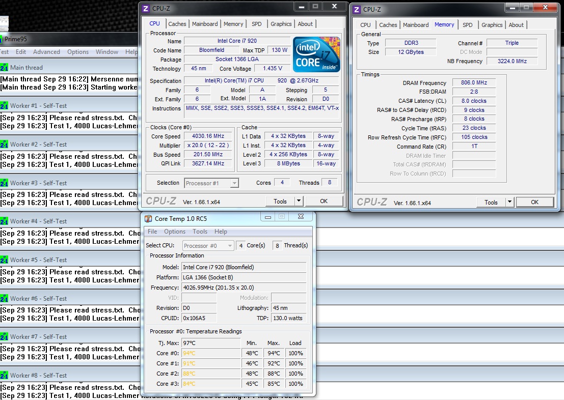

Post by skier »

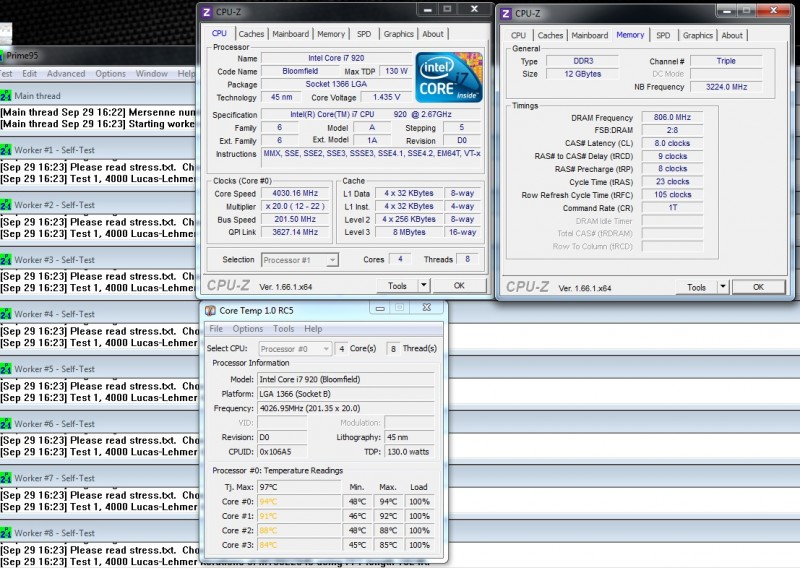

Still getting pretty toasty at 8-thread load 8-[
Lapping heatsink and IHS are my next step, right now the fans are all on a Silverstone fan controller (with a couple ghetto 3-pin extensions) and spinning relatively quiet so I think i'll see if I get this as my 24/7 clocks now
-Austin

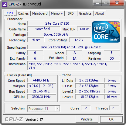

Post by skier »
Final update on the 920: 2-core ballz out overclocking. It didn't boot more than once at 212 BCLK, but once is all I needed :mrgreen:
Now to pull and play with the W3520 :)
-Austin

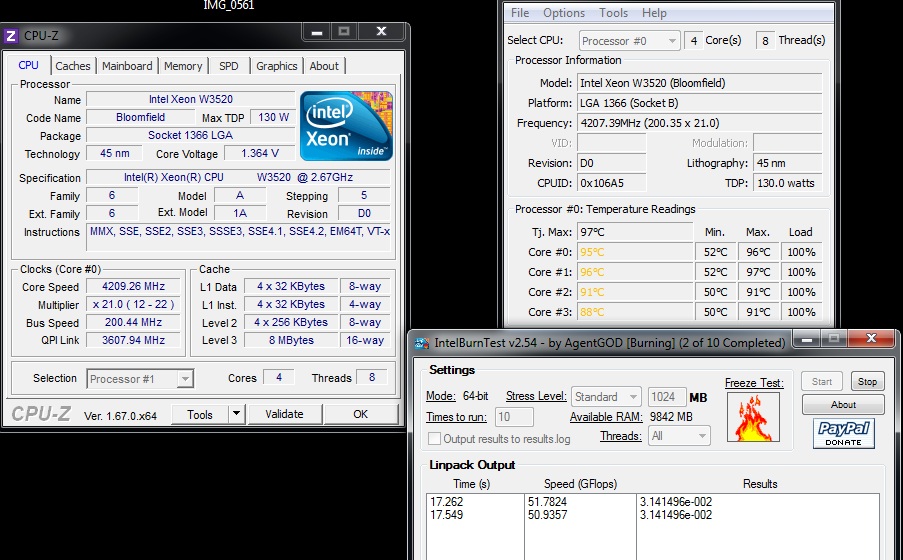

Wasn't planning on even installing it yet, but...
Stock Vcore, and stock VTT
~final 24/7 clocks:
It gets a liiiittle toasty too, need to lap this DH14 :-k
-Austin

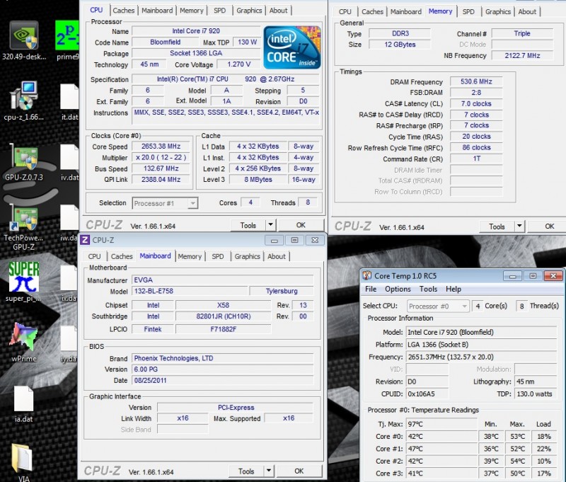

Going for all the Gusto she has:
Because a new friend showed up earlier this week
Let the saga continue..
-Austin

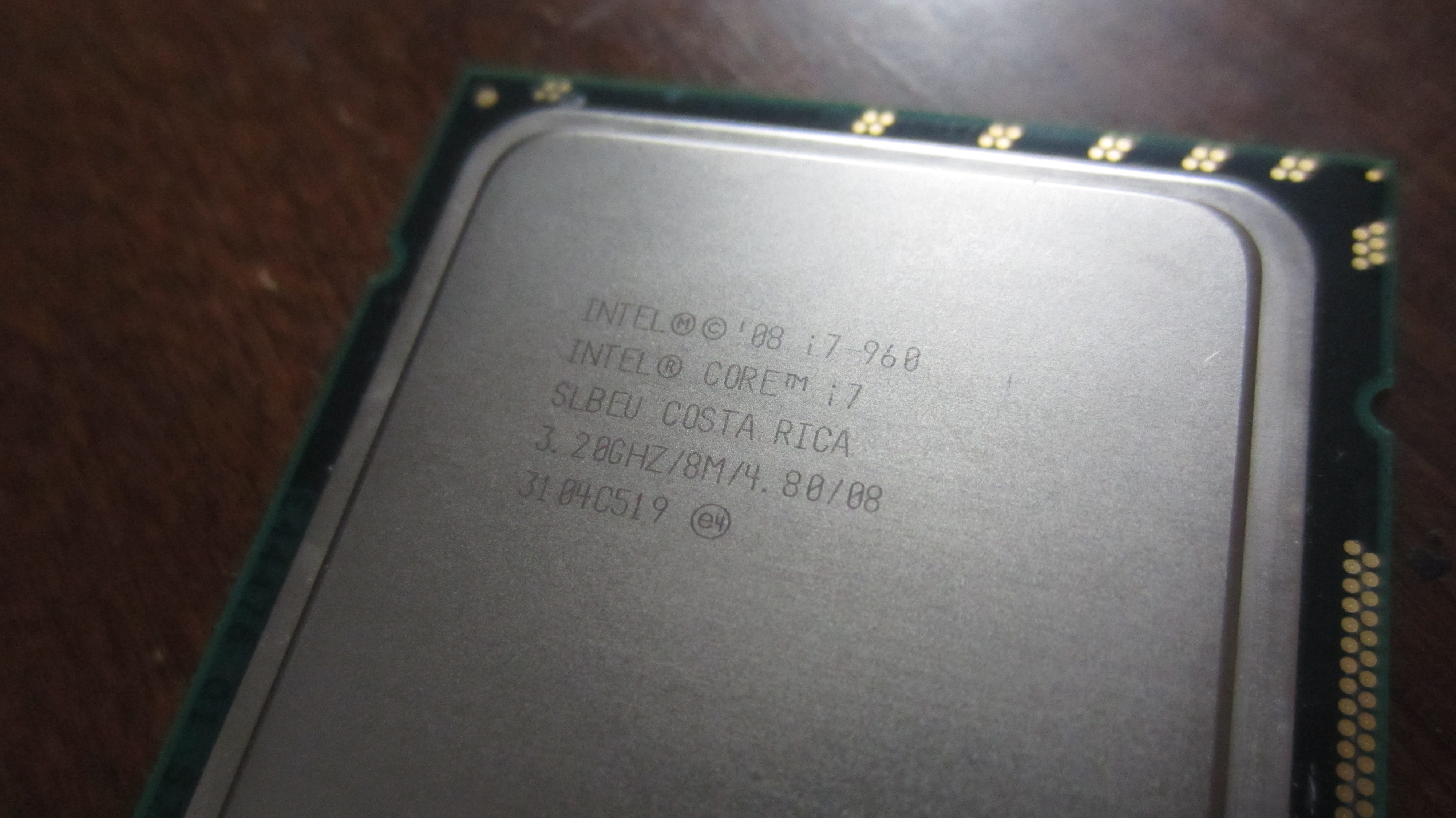

Also latched in the 960:
Not a bad first boot :mrgreen:

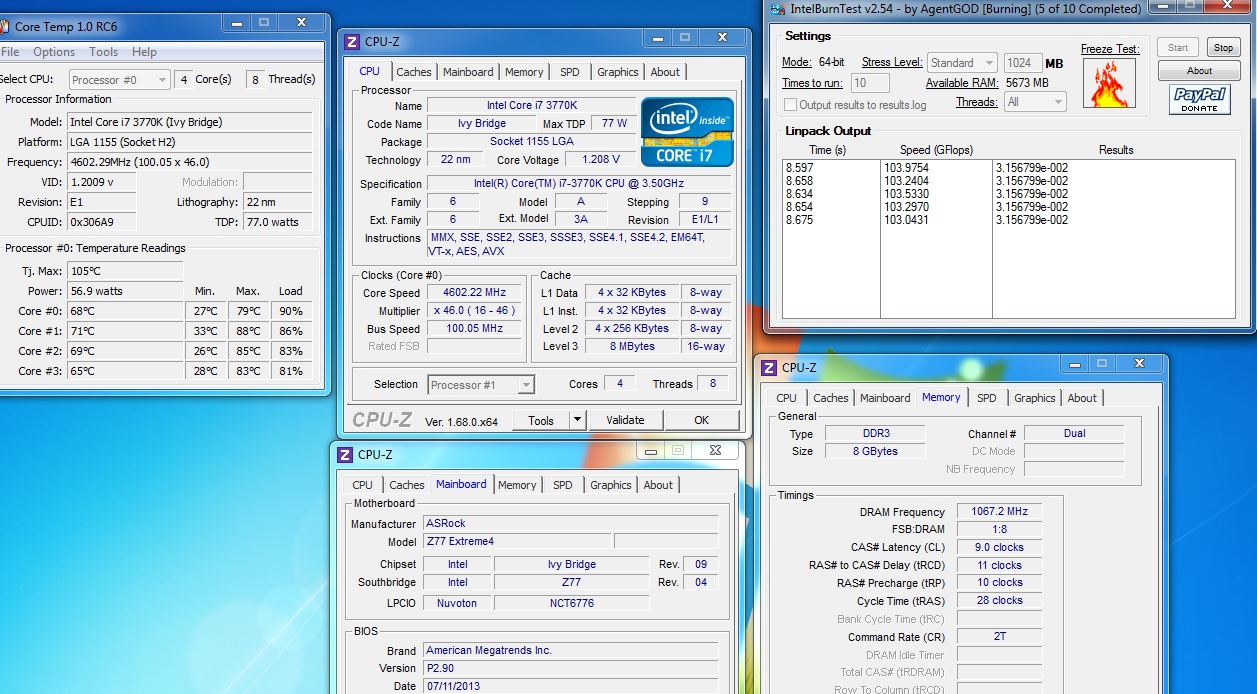

Post by skier »
Through an unfortunate circumstance, I have now acquired an HP 3770k-based system and grabbed an Asrock Extreme4 to go with it for my main rig, so the Lapped W3520 and all my shiny X58 gear will be heading off to ebay
Quite surprised to see the difference in GFlops between the 4.2GHz W3520 and the 4.6GHz 3770k (better than double! :shock: )
The clocks above are manual, after a half hour of tweaking.
edit: 4444!!!!
