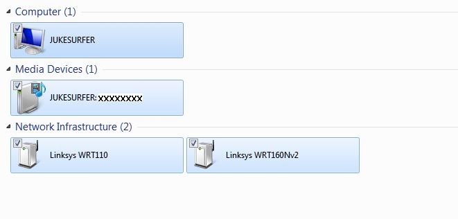

I don't have any network shares, no printers on the network, I don't have homegroup set up because right now I don't share between the computers on my network. This is what my network window looks like:
Those two routers aren't in my network (I use a DIR-850L) but I was told that since they are within range of my adapter on this box (main level) Windows7 has them listed in there for ease of joining those networks with wifi direct if I so desire (click to configure and it asks for pin numbers). I don't know why those two particular ones show up when I have 20 neighbors' wifi networks show up on my adapter's connections lists, maybe it is because these two routers have networks that are open with no security setup? I do see two networks that are unsecured at the time of this writing (coincidence?), one of them labelled "GoldCheetah-guest" is setup as a pay-by-the-hour connection since I tried hooking to it once and it popped up a paywall. Methinks if their provider knew about that they would lose their service, lol. If they have Charter like I do, they would be in trouble for it I'm sure.

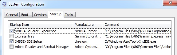

I think most of your problem is the apps that load at boot then, primarily your AV. I personally only run AV scans if I can already tell I have a virus, which is rare but I'm the only one that uses my PC (Built a separate one for the Fiancee to play the Sims :) )
Why would you load Aida64 at boot? I havn't used it since the Everest days, but isn't it just the gawk at your specs every once in a while or if you forget whats in your system? (chipset, BIOS etc.) I just use CPUz and GPUz
of your list, I would turn off MBAM and Aida (unless you paid for MBAM pro)
for reference, my boot time with my i7 at 4GHz and a Toshiba 128GB SATA3 SSD (on a SATA2 controller) is about 20-25seconds from powered off to fully loaded desktop, again with no AV at boot (have MBAM free I use only if needed)
I should actually kill GeForce experience while I'm at it 8-[
