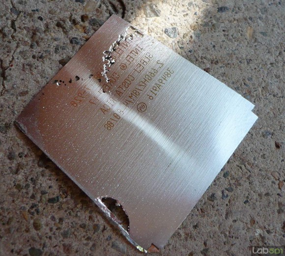

The Indigo is a liquid metal, not really a paste, end up with a custom fit thermal shim basically. There is a bit of a process to get it installed, not like paste that is a "squirt and run" thus the exotic label. Some have reported over 5*C lower temps over most pastes.
Here is a shot of indigo pulled off a chip after installing.
Not my image, from http://translate.google.com/translate?j ... l=ro&tl=en

Wow!! That's crazy! I guess the bubbles are from where there wasn't enough of the compound on the proc at the time. Looks like it pulled the ink right of the processor die!

Not ink, laser etch.
